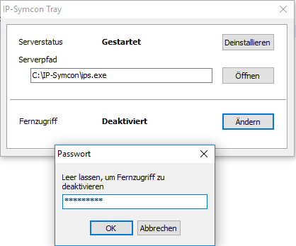

Windows
Through the tray application a dialog can be opened via "Right-Click -> Information". At the bottom of the dialog, an item "Remote Access" can be found. There, the password can be set.

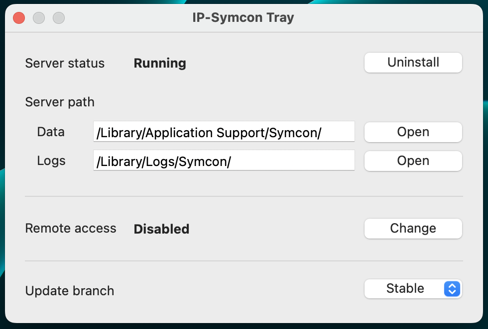

MacOS
Through the tray application a dialog can be opened via "Click -> Information". At the bottom of the dialog, an item "Remote Access" can be found. There, the password can be set.

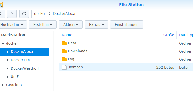

Synology
The license must be configured in the Management Console. Afterwards, an editor must be used to update the .symcon file. It can be found in the Root volume selecting during installation.
The path is based on the one defined during the Installation of IP-Symcon. It can vary.
There should be several entries. The following must be inserted in a new line. (Do not leave empty lines!)
Password=c3ltY29u
Then save and exit. The service must be restarted.
The password c3ltY29u is "symcon" encoded in Base64. The password must be Base64 encoded. This tool can be used for this purpose: base64encode.org
