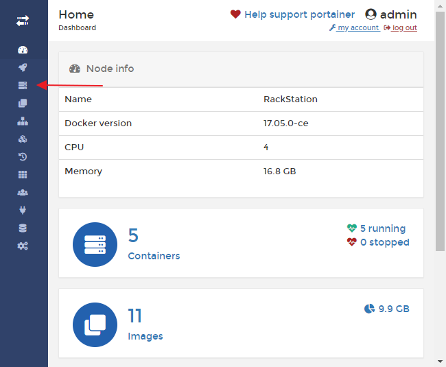

After the installation, the interface as available under http://127.0.0.1:9000/. Eventually, the IP address needs to be adjusted. During the first configuration, a password needs to be defined and a connection needs to be established to the local server in a next step. After succesfull installation, the interface should look as shown below.

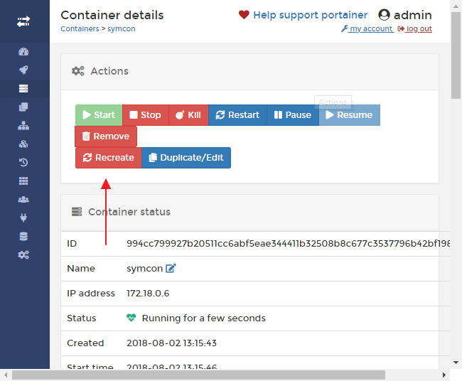

In the tab "Containers", the "symcon" container can be selected. The option "Recreate" enables a comfortable update. In this process, the container will be deleted, the new image downloaded, and installed with the same settings. Depending on the internet connection, this may take some minutes.

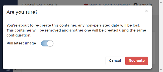

It is important, that the option "Pull latest image" is activated in the confirmation dialog.
