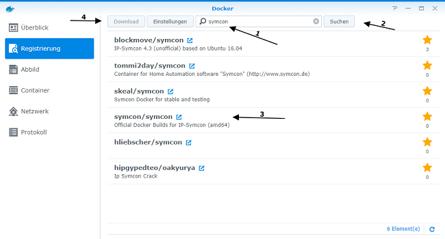

- Search for Symcon in the registry and download the image (choose a tag, e.g., latest)

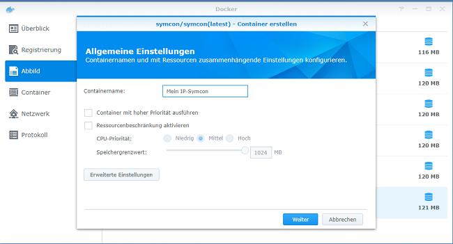

- Choose the new image under Image and click Start
 - Choose a name

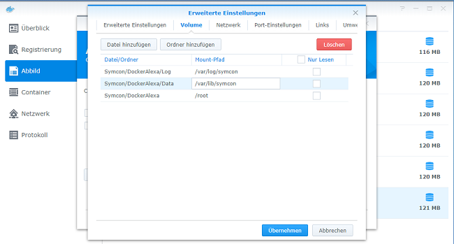

- Adjust the Volume Settings (/root, /var/lib/symcon, /var/log/symcon need to be stated!)

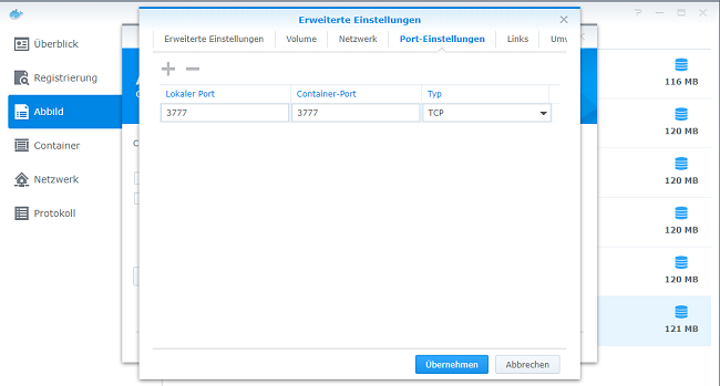

- Adjust Port Settings (3777 to 3777)
- Confirm with OK, click Next and start the container with Apply
