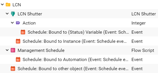

Binding to Action Target
Die bound object is used as target for an Action . As is common with actions, an action can be selected depending on the target and configured.

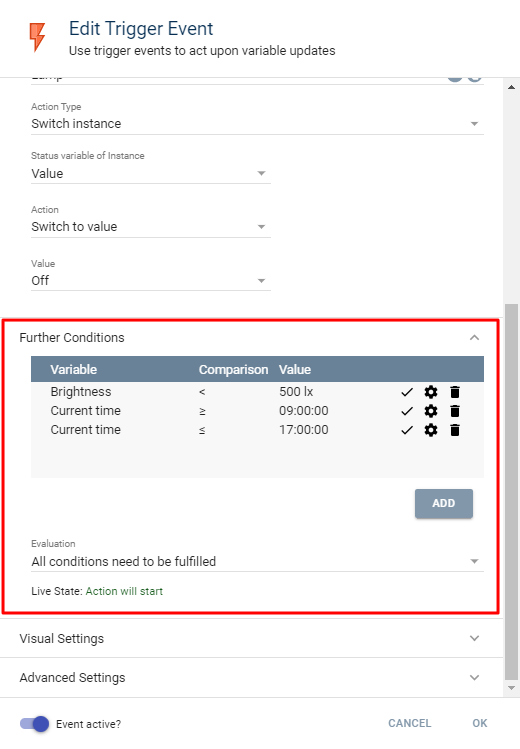

Conditions expand events by further options that need to be fulfilled for the event to trigger. This can be used to realized multiple conditions.
Additional conditions can be added in the expansion panel "Further Conditions". In this panel, new conditions can be added by clicking "Add".
The types Variable, Date, Day of the week, and Time can be selected. For the type "Variable", a variable needs to be selected. Afterwards, the remaining options will appear.
Finally, the comparison operator (see table Comparison Operators) and the compared value need to be defined before confirming the condition with "OK".
In the table, all defined conditions are listed. An X symbol shows that a condition is currently not fulfilled while a dash icon symbolizes that it is fulfilled. The gear icon can be clicked to modify the condition, the trash icon will remove it.
In the dropdown "Evaluation" it can be defined whether all conditions need to be fulfilled for the event to trigger or if a single conditions suffices.
The Live State shows if the event would currently trigger based on the conditions or not.

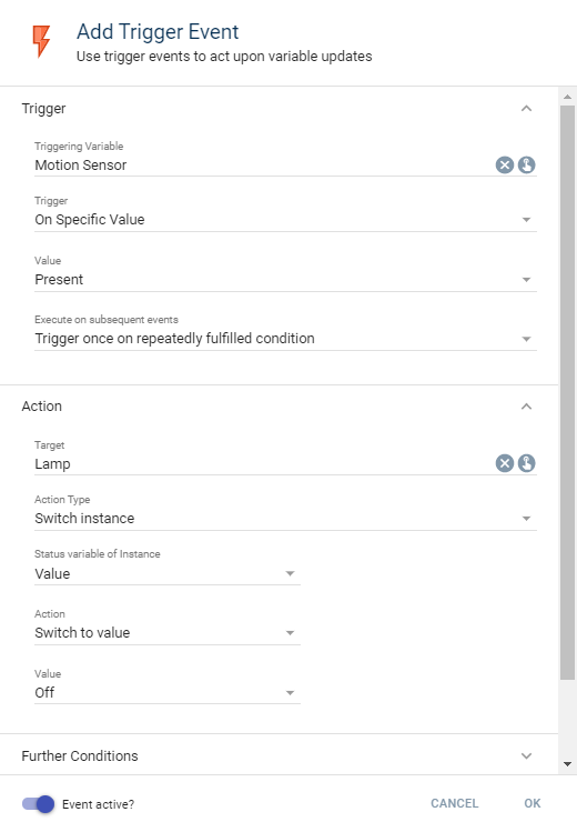

First, a triggered event is created. The motion sensor is defined as trigger on the value "Present" and the lamp is selected as target instance, switching its value to "On".

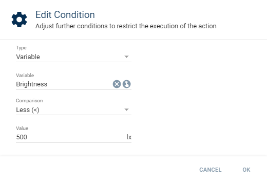

The light value "Brightness" is configured as "less" than 500.

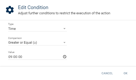

The time is configured as "greater or equal" to 09:00.

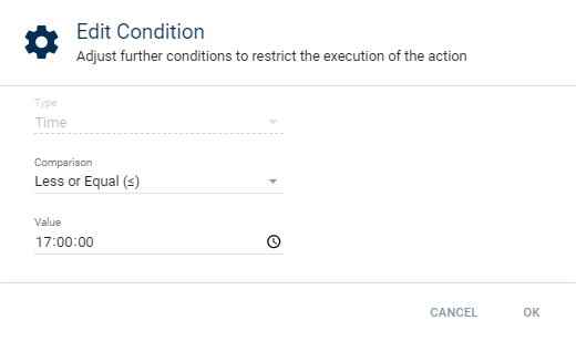

The time is configured as "less or equal" to 17:00.
In the overview, all three rules are listed and the live state shows if the light would be switched on if the motion sensor would trigger at this moment.
