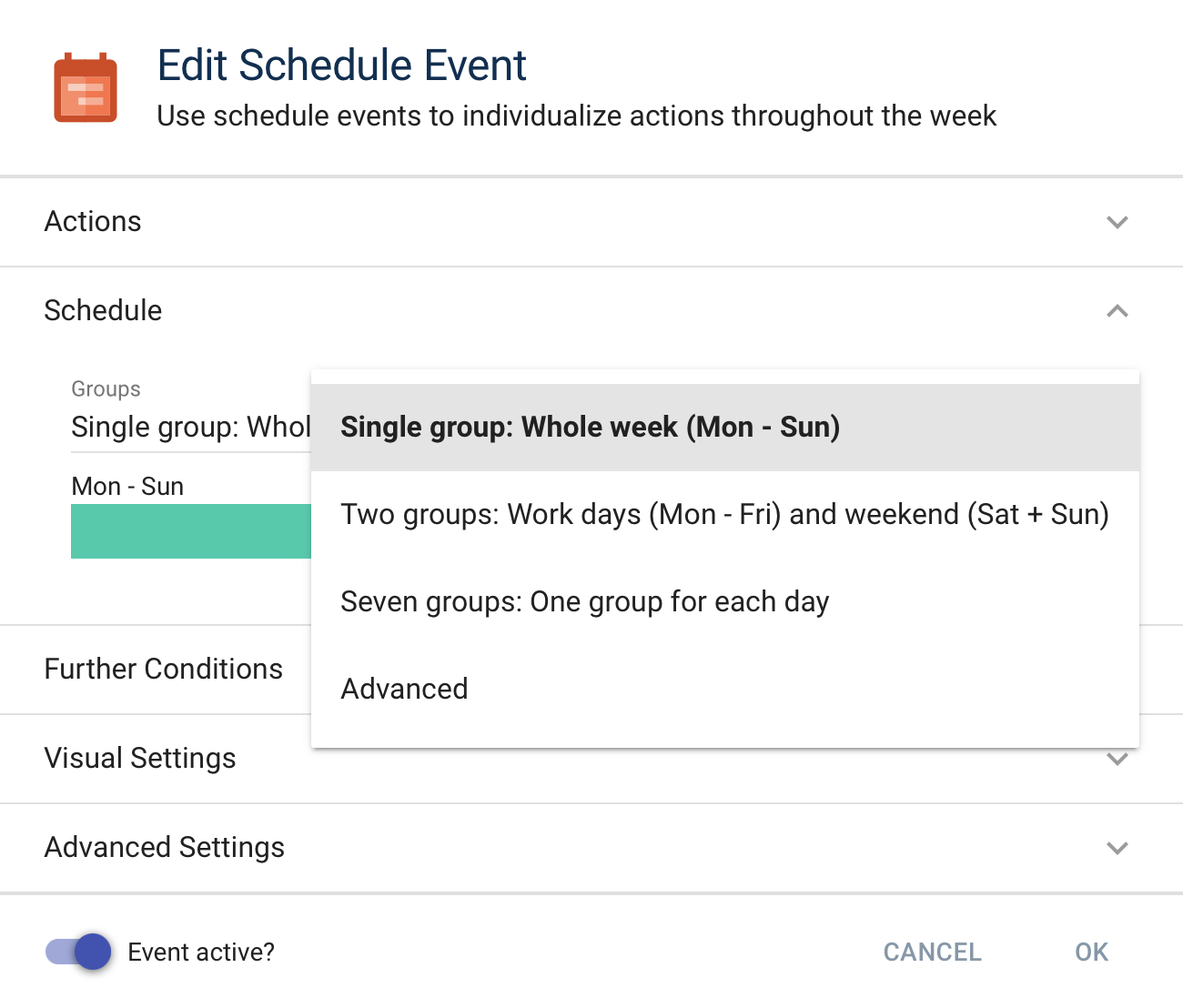

Group Types
There are four options
Type | Description |
Single group: Whole week (Mon - Sun) | All week days are summarised in a single group. |
Two groups: Work days (Mon-Fri) and weekend (Sat + Sun) | Splits the week into two groups and allows the days from Mon-Fri and Sat+Sun to be configured independently. |
Seven groups: One group for each day | Every week day can be configured individually. |
Advanced | The week days can be combined as required. Each combination is summarized into one group and can be configured. |

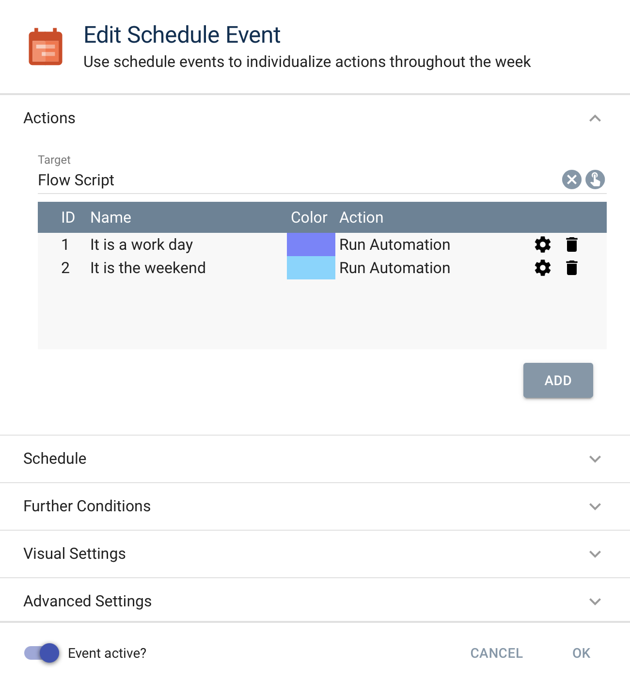

The schedule offers actions depending on the selected target. At least two schedule actions need to be configured. As part of the schedule action, an Action is defined for the target.

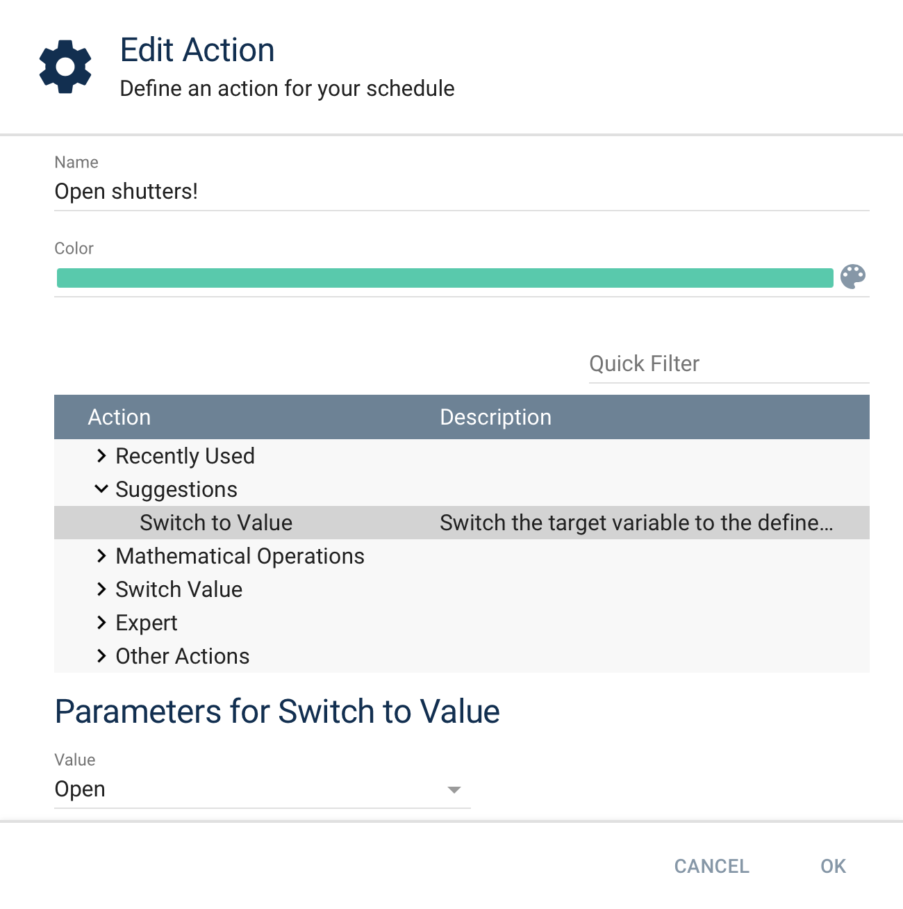

Add schedule action
A schedule action can be added by clicking on "Add". For the schedule action, a name, a color, and an Action are selected.

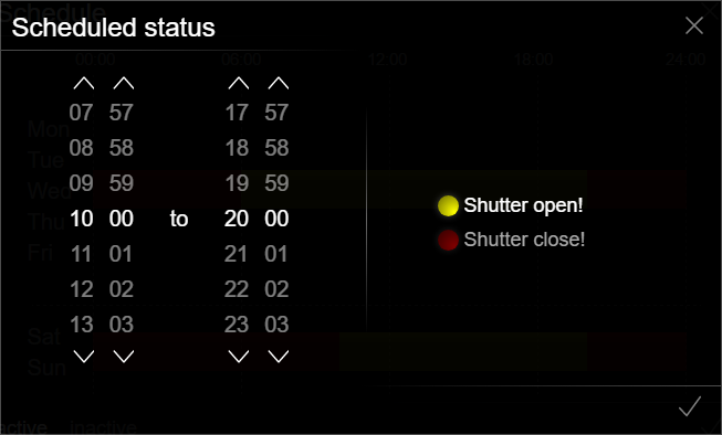

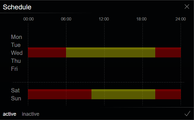

The durations of the actions can be configured within the Management Console or the WebFront.
Within the grafical interface, the following applies:
Single Click configures an existing state.
Click & Pull creates a new state.
The selected action is only executed when the action changes.

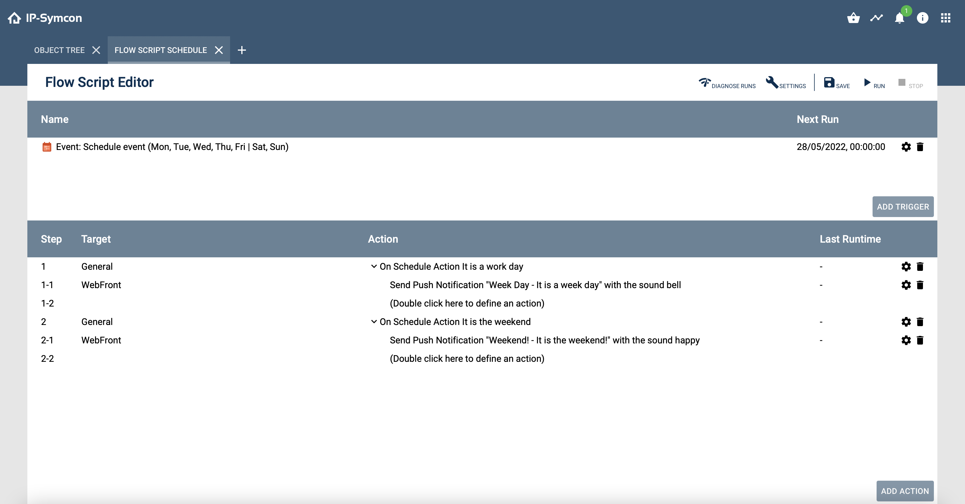

Bind to flow script
If the action "Run Automation" is selected for a Flow Script, the action "On Schedule Action" can be used to execute a number of actions on a specific schedule action. When the first schedule is added as trigger, the "On Schedule Action"-actions are added automatically.
Example with flow script
This is an example flow script which is executed via schedule.
