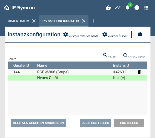

Configurator
All IPS-868 devices can be created as Instance using the IPS-868 configurator. To do this, "New device" must be selected from the list and "Create" clicked on.
New Instances are created in the Object Tree in the main category. These created instances can then be renamed accordingly and sorted elsewhere. A newly added device can be configured via "Configure".

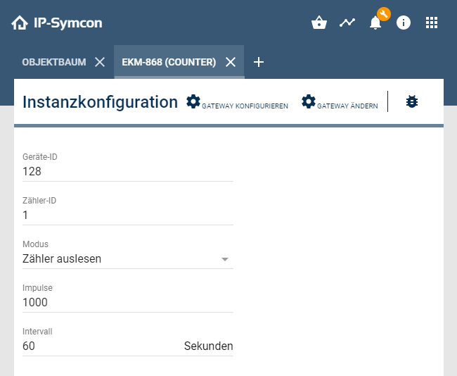

Here, on the one hand, the device ID must be entered here and, depending on the device, other device-specific properties may have to be defined. The exact procedure and the device ID can be found in the documentation of the respective device. (device list )
Configuration
Various properties can be set on the configuration page of the device.
These can be found in more detail in the respective device documentation.
