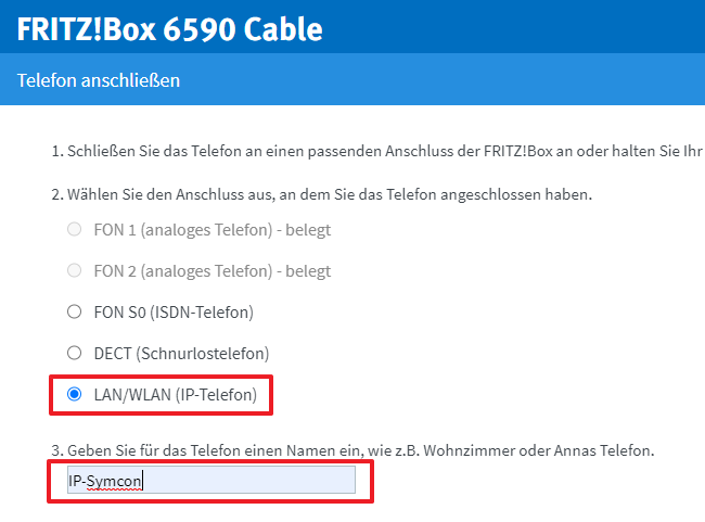

As a first step, a new telephony device must be added to the FritzBox under "Telephony" -> "Telephony Devices".
This must be added as a new "phone".

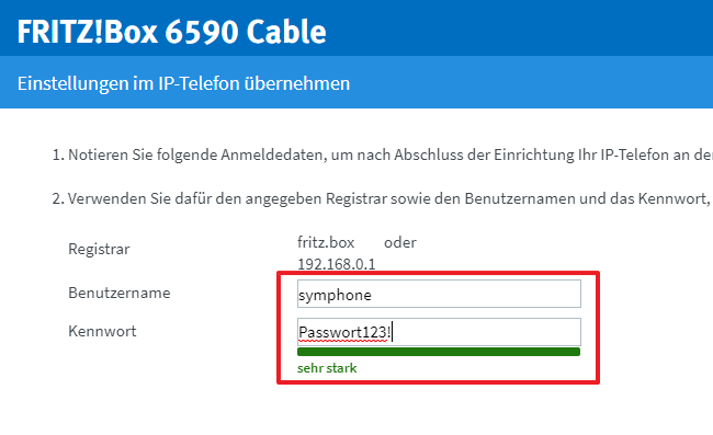

Since IP-Symcon acts as an IP telephone, this and then a separate telephone number must be selected. A descriptive name should be chosen for the telephony device.
Then a user name and password must be specified, these are later entered into the VoIP in IP-Symcon.

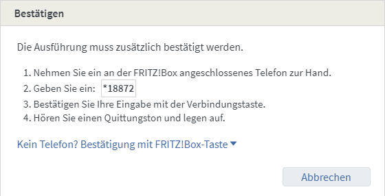

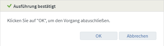

The telephony device to be set up must be confirmed and its setup then completed.

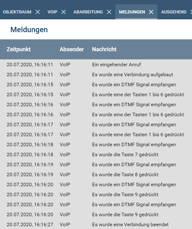

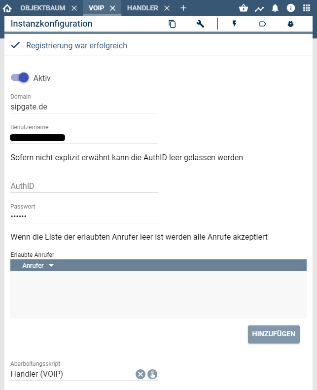

Now the telephony device can be taken over in IP-Symcon within the VoIP module.
If everything went well, the status "Registration was successful" is displayed.
A test call can be made with the Processing-Script set up. In the Messages the following messages should appear when the number keys on the phone are pressed.
