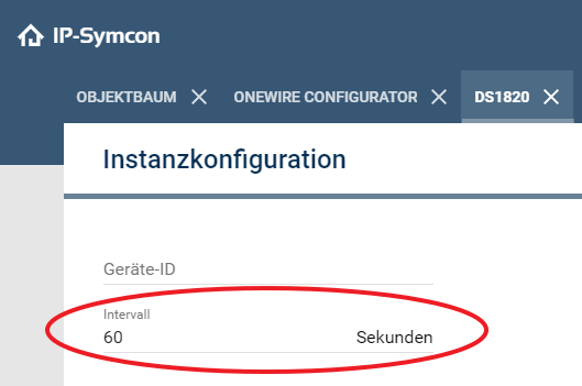

The building blocks that are connected to the 1-Wire bus do not send their values automatically - they must be requested. The Interval in the respective instance configuration defines how often the request is done.
1-Wire: Timer
Every request takes time and occupies the bus. For this reason, the "Interval" should be used sparingly. In practice, for example, a request cycle of 60 seconds to read a room temperature is more than sufficient. Smaller values under one second cannot be configured for that reason.
