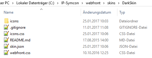

Folder structure
Structure of the skin folder
Skinname
- icons (optional)
- img (optional)
- font (optional)
|    - WebFont.ttf
- skin.json (will be generated)
- webfront.css (required, even if empty)
- icons.css (will be generated)
- README.md (optional)
