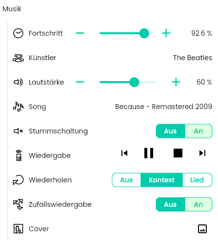

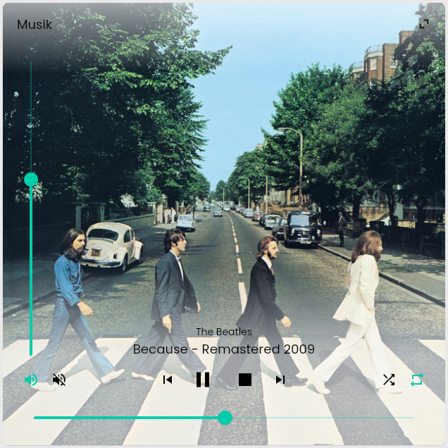

As own Tile
Within a List
In the list view, the visualization falls back to the presentation List.
Appearance in the WebFront
This display is not supported by the WebFront. Instead, variables are displayed as Enumeration and instances are displayed as List.
