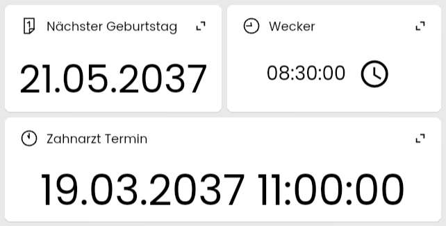

As own Tile

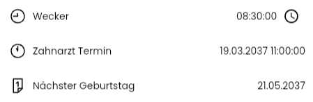

Within a List

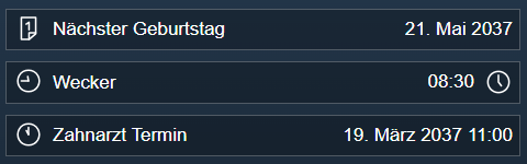

Appearance in the WebFront
