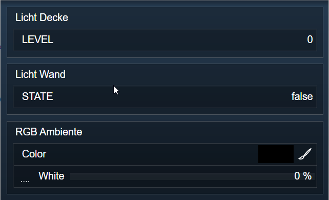

Given are 1 Homematic actuator for switching a light, 1 Homematic actuator for dimming a light and an IP-Symcon 868 actuator for operating an RGB strip:
The actuators can be switched separately via the WebFront:

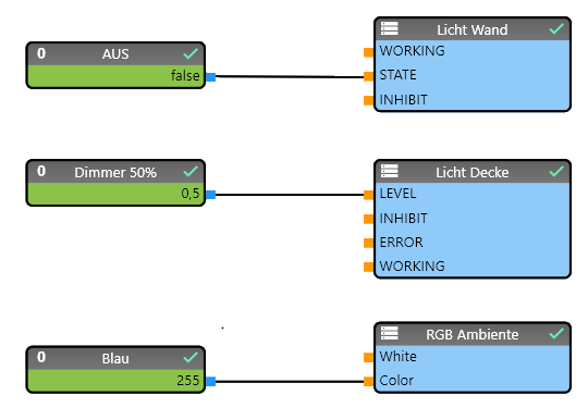

A logic script is now to be created in Logic Scripts that sets a specific lighting scenario and assigns predefined values to the individual lighting fixtures.

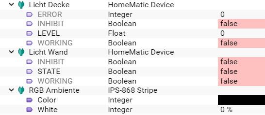

You can realize these values by using constants, predefined instance modules for setting the values can be found in the Object tree of the Logic Script Designer.
In this specific case, the RGB luminaire is assigned the color blue, the wall light is switched off and the dimmer is set to 50%.
