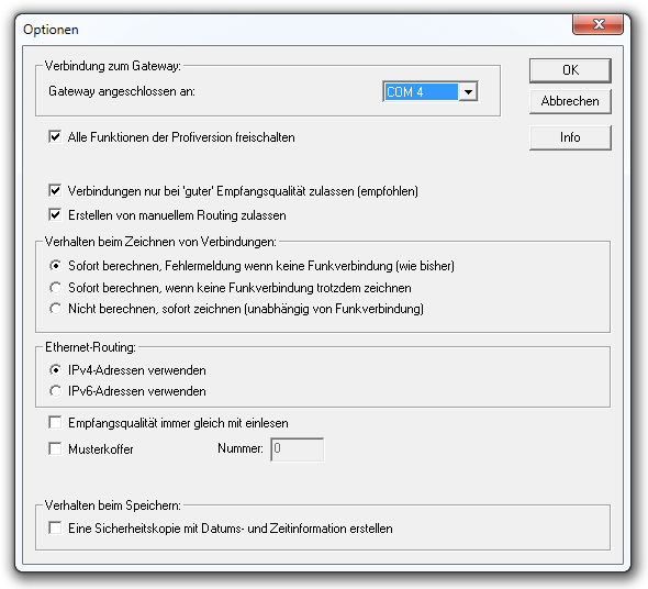

After the correct connection of the device(s), "Control Panel -> Hardware and Sounds -> Devices and Printers" must be opened. There you have to look for "Prolific USB-to-Serial Comm Port". The used port (e.g.: COM4) can be found in the brackets behind it, this should be noted or remembered.
The Eaton Firmware / MRF Software must be downloaded and installed. After starting the software, click on "Edit -> Options", select the correct port (e.g. COM4) and activate the appropriate options.

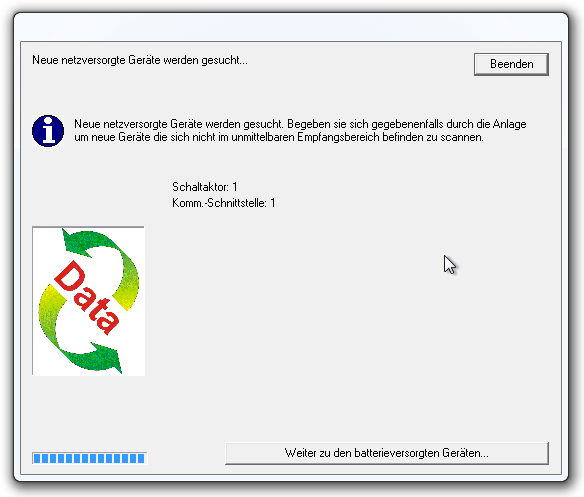

This can be done in the upper tab via "Actions -> 2x Read".
Now the system will first search for the mains powered devices. If necessary, you have to go near the secondary devices for scanning, if they are not in the immediate reception area.
Eaton 2
When all mains-powered devices have been read in, "Continue to battery-powered devices" must be clicked. The battery-powered devices must now be activated so that a connection to the gateway can be established. After this has been done, "Exit" must be clicked. Now a password entry is requested. It should be entered as password "0000" and confirmed.

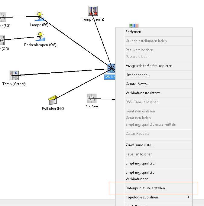

So that Symcon later knows what is on data point 1 or on data point 2, for example, the right mouse button must be clicked on the gateway and then the left mouse button must be clicked on "Create data point list". This must be saved. Finally, the entire project must be saved. The Eaton firmware is no longer required.

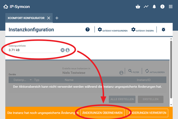

In the management console, an ‘xComfort Configurator’ can be created in the object tree via ‘Add object -> Instance’. After selecting the mode appropriate for the gateway used, the connection to the gateway is configured.

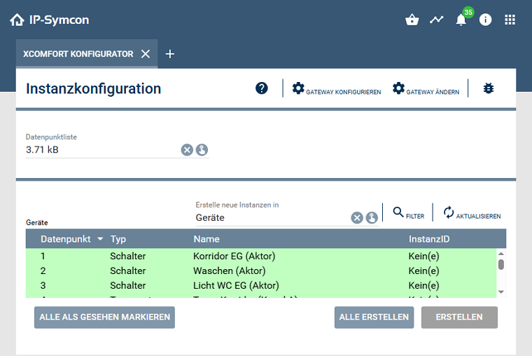

Depending on the mode, an IP address must be entered, the Comport selected, or the appropriate USB device chosen, and the I/O activated. Finally, after confirming the dialogue, the configurator will open. Use the ‘Data point list’ file selection to upload the previously saved data point lists. Once the changes have been applied, the devices can be created.
To receive routable feedback, the data point list must have been loaded in the configurator. This is the only way to assign a serial number to a data point number
Select Data point list
Devices in Configurator
