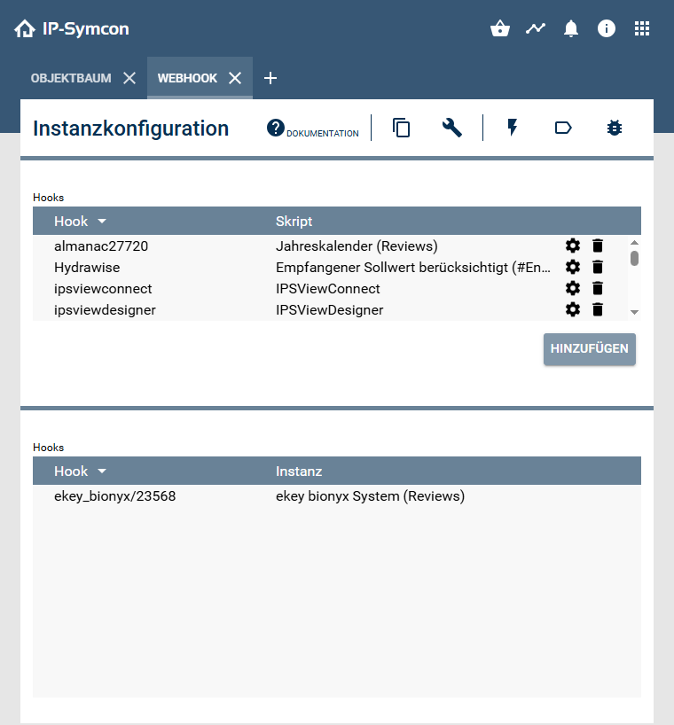

Within a browser, the respectively linked script can be called with "IP:PORT/hook/HOOKNAME".
To set up a hook, "Add" of the first list must be clicked on in the "WebHook Control" instance. The call name of the hook must first be entered and then the script to be executed by the hook must be selected.
Calls via Connect Control are also possible.

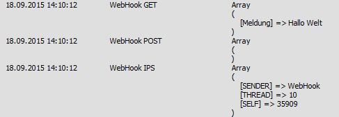

The sample script to be called is "WebHook TestScript" with ObjectID "35909".
IPS_LogMessage("WebHook GET", print_r($_GET, true));
IPS_LogMessage("WebHook POST", print_r($_POST, true));
IPS_LogMessage("WebHook IPS", print_r($_IPS, true));
IPS_LogMessage("WebHook RAW", file_get_contents("php://input"));
echo "Message: " . $_GET['Message'];
The call and the result would be as follows:
Browser
The data is passed to the script in arrays at Symcon.

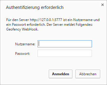

An example of how automatic authentication was implemented via the Control module.
"Symcon" was selected as the user name and "password" was selected as the password.
Authentication is always recommended to prevent unauthorized access to Symcon from outside.

If the hook is called, the query for username and password appears. And the data is sent to the script via $post array.
