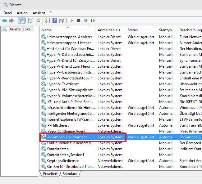

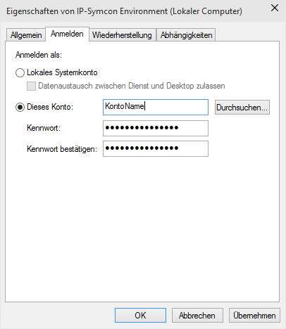

Warning: % was not found in [...] on line …
If the error message appears, it indicates an access problem. Likely the file to be written is locked by another process.
Furthermore, it is not possible to write on NetworkPath.
