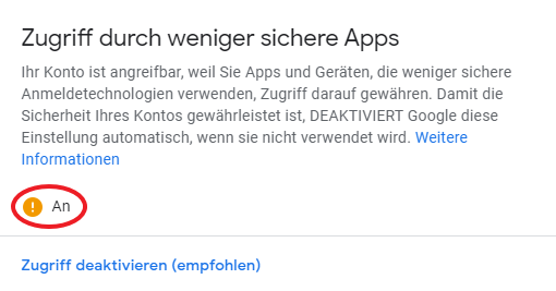

For use without two-factor authentication, "Access through less secure apps" must be activated in the administration of the Google account under "Security". A direct link would be myaccount.google.com/lesssecureapps .
When access is enabled, it looks like this. Username and password can now be used to log in.

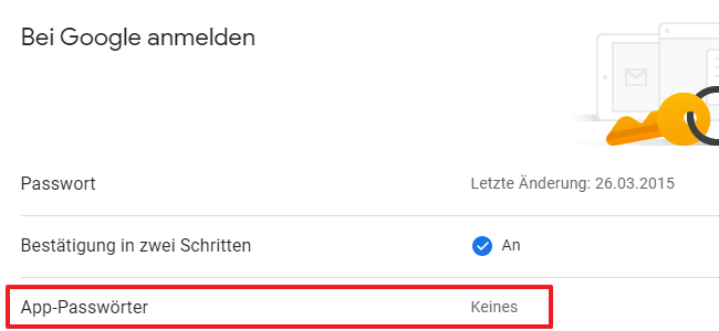

When using two-factor authentication, an app password must be assigned in the administration of the Google account under "Security" in the "Sign in to Google" section.

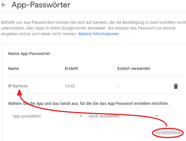

Click on the line "App passwords".

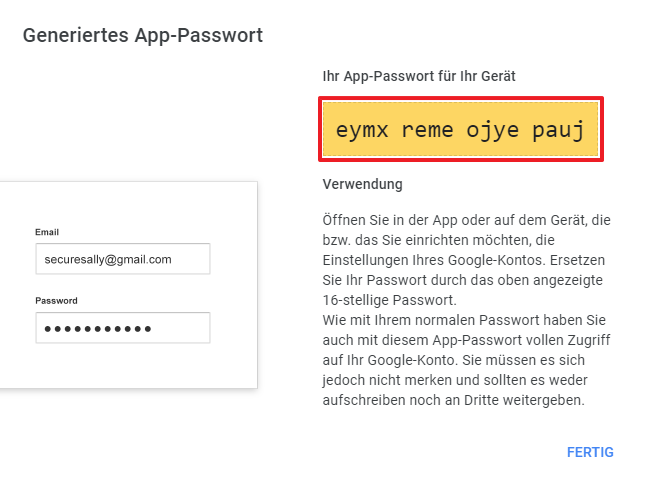

A new password with an individual name can be generated in the overview.

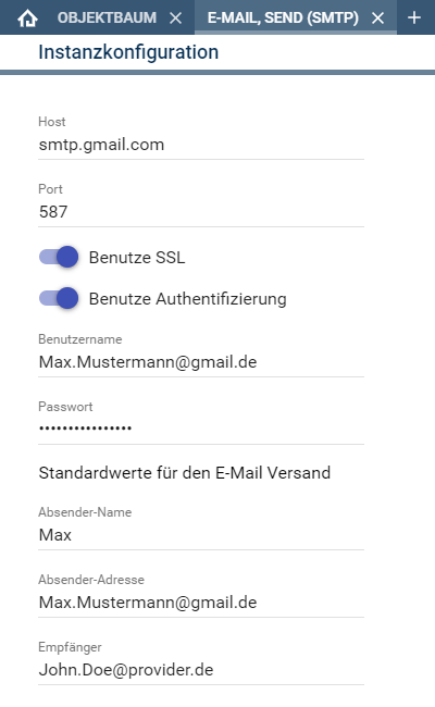

The generated password must then be entered in IP-Symcon.
