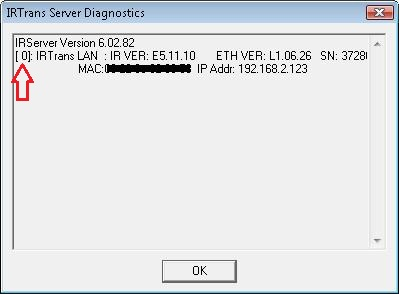

With the IRTrans Tray Icon (right click -> Diagnostics), the IDs of the devices can be queried, that were found by the IRTrans server application, which can then be controlled via IP-Symcon. The following figure shows an IRTrans LAN device that has the ID 0.

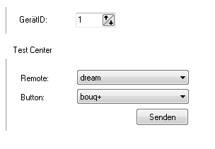

The manufacturer recommends the learning of the commands via the "IRTrans GUI Client". First, you must enter the name of the remote control (e.g. "sat") and the appropriate key (e.g. "power"). A teaching about IP-Symcon is not possible.
In the configuration of the IRTrans instance the device ID must be specified, which can be removed from the upper diagnosis window. Each instance can control a single device. Any number of IRTrans instances can be created. If you want to send to multiple devices, multiple PHP commands can simply be sent to multiple instances in a row. The function can be checked in the Test Center.
