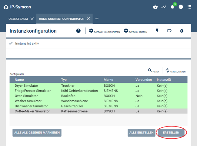

When a device is created by the Home Connect configurator, a Home Connect device instance is created which has various status variables depending on the device type.

  • When creating a device, it should be online and therefore switched on
