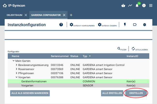

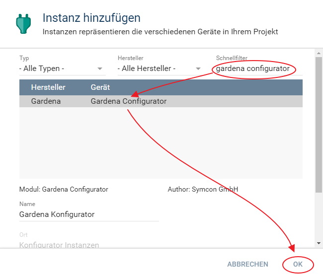

An instance can be created for each service with the configurator.
In the instance configuration, the 'Show last transmitted' switch can be activated to create a variable for each value, if available, that contains the time of the last data transfer.
