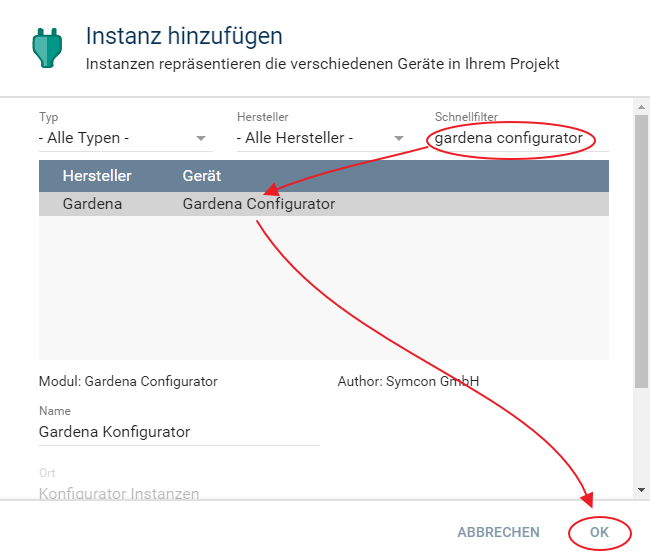

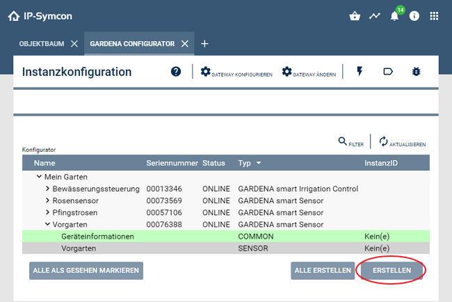

An instance can be created for each service using the configurator.
In the instance configuration, the 'Show last transmitted' switch can be activated to create a variable for each value, if available, that contains the time of the last data transfer.
Service | Description |
General | Contains general information about the device |
Valve | Represents one of the 6 valves of the irrigation control |
Main valve | The main valve with which all valves can be closed |
