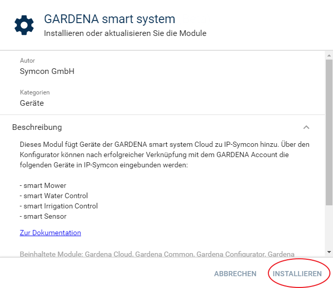

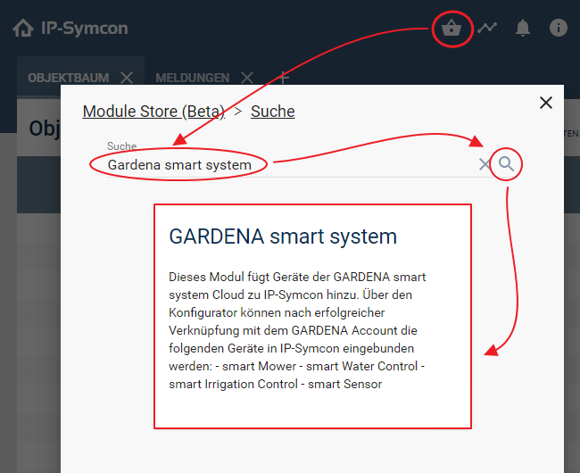

In order for the GARDENA module to be used, it must first be installed via the Module Store. The Module Store must be opened for this. It is located in the upper right area. The Gardena smart system module can be found via the search field by entering "Gardena smart system". When opening the found module, the installation of the module can be initiated in the following dialog via the "Install" button.

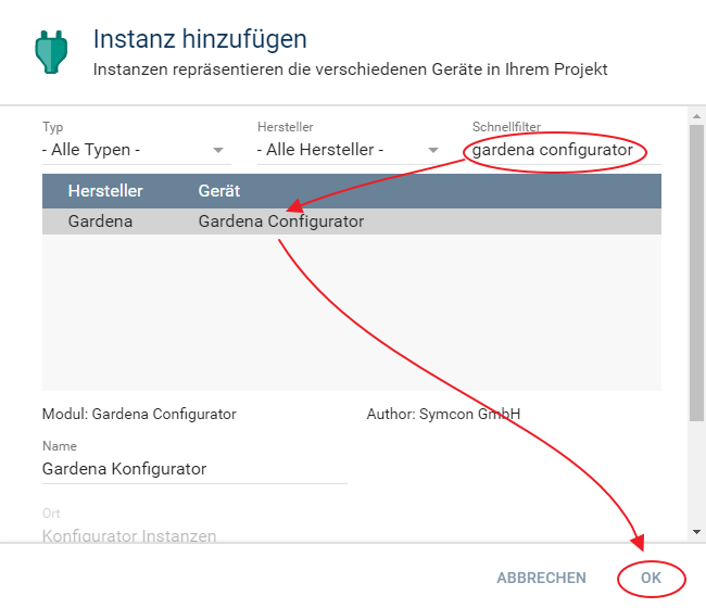

If the instance is to be added manually, an Instance must be created by the Gardena configurator. To do this, the object tree must first be opened. Here, the "+" button at the bottom right must be pressed and Instance selected.
The "Gardena Configurator" from the manufacturer "Gardena" can be found using the quick search. The location should not be changed, the name can be chosen freely. Finally, confirm with "OK".

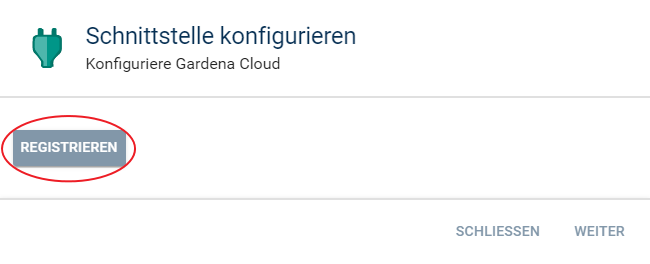

Before devices can be created, they must be registered by clicking on Register in order to connect IP-Symcon to the Husqvarna Group account.

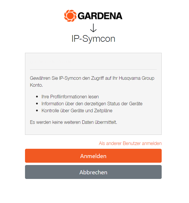

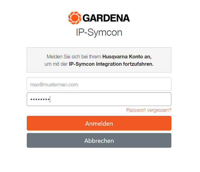

One has to log in with the Husqvarna Group account in order to grant IP-Symcon the necessary authorizations.

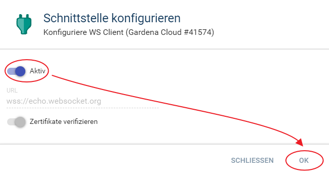

The "Configure Interface" dialog can then be confirmed with Next. Now the created WebSocket Client has to be activated.

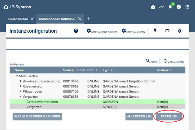

Now the configurator opens and all recognized devices can be created with a click on "Create".
