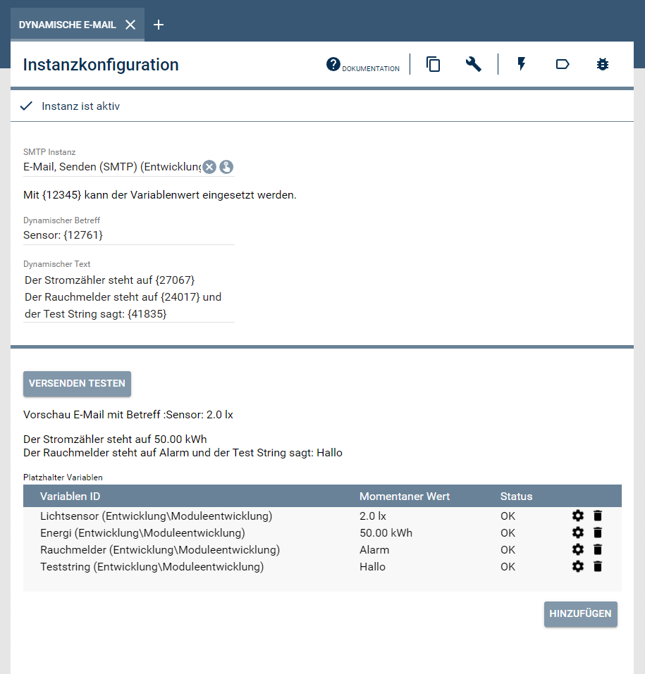

Configuration page:
Name | Description |
SMTP instance | SMTP instance which is fully configured |
Dynamic subject | Text input which can be set. |
Dynamic text | Multi-line text input. |
The subject and the text are given a dynamic by inserting variable values. These can be set within the text by the variable ID placed in curly brackets. If the ID is too short or not a variable, the brackets with the number remain.
Action area:
Send Test | Sends an e-mail with the set subject and text |
Preview e-mail with subject | A preview with set variable values |
Placeholder variables | Table with the given placeholders |
Table:
The placeholders found are listed in the table with their current value and status. If a placeholder is not available, the number entered is not an ID. If a placeholder is invalid, the ID found is not a variable.
