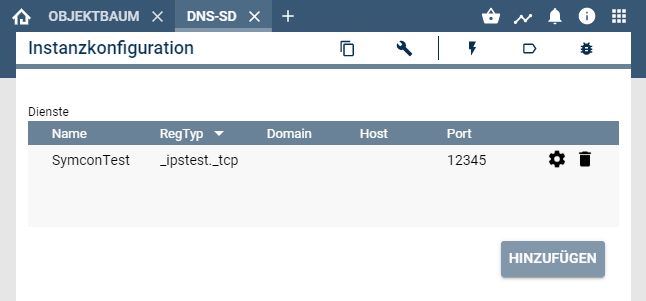

New services (list element) can be added via the configuration page of the DNS-SD Control.

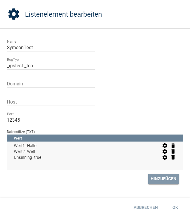

These need a Name, RegType and Port. Domain and Host are optional, as are values. These are saved as key -> value pairs.
The same Name and RegType may not be reused for different list elements.

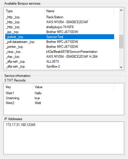

After successfully adding, the new RegType and Name can be found and used directly via a Bonjour browser.
