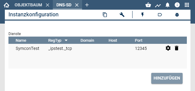

New services (list element) can be added via the configuration page of the DNS-SD Control.
configuration page

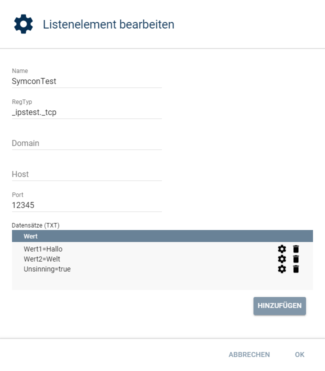

These need a Name, RegType and Port. Domain and Host are optional, as are values. These are saved as key -> value pairs.
The same Name and RegType may not be reused for different list elements.
List element

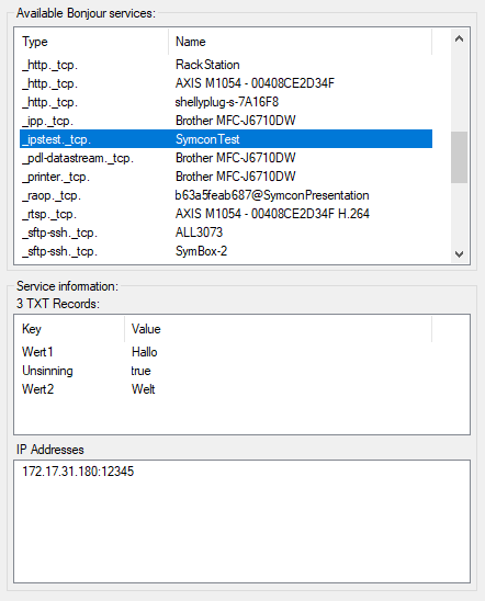

After successfully adding, the new RegType and Name can be found and used directly via a Bonjour browser.
Bonjour Browser
