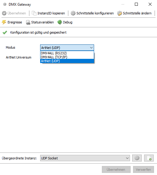

A DMX instance must be added in IP-Symcon and the DMX or ArtNet mode for the connected hardware must be selected in the parent instance. With ArtNet the "Universe" is usually 0 and with DMX the entry is irrelevant.
DMX gateway configuration

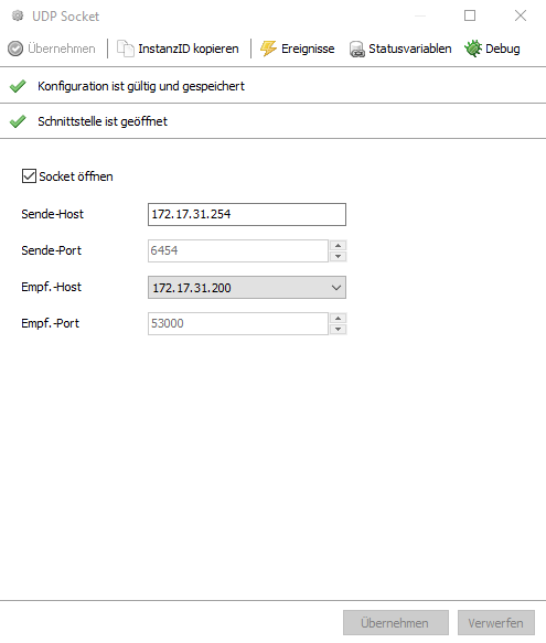

When using ArtNet, the following settings must be made in the parent instance:
'Send Host' is the IP address of the ArtNet interface and the 'Send Port': 6454 - the default port of the ArtNet protocol.
'Receive Host' is the IP address of the network card to which the interface is connected. It is usually the address of the PC on which the IP-Symcon server is running.
If several ArtNet interfaces are created, the receiving port (default: 53000) must be increased by 1 for each each UDP Socket. (i.e. the second interface has e.g. port 53001)

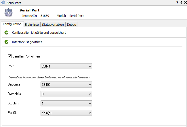

With a DMX interface that is connected via USB, a virtual COM port is installed in the Windows device manager. This is to be entered here. The other baud rate settings: 38400,8,1,N must not be changed.
Once all the settings have been made, the port or socket must be opened and "Apply" pressed.
DMX Serial

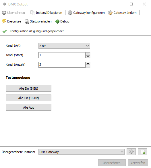

In the 'DMX output' instance the functionality can be checked in the test environment.
DMX Output
Several channels of the DMX device can be addressed with one instance. This is useful, for example, to be able to display complete DMX-RGB spotlights as a coherent device in the visualization. All channels assigned to the instance can be switched on or off using the "All On" and "All Off" buttons.
In the case of a DMX RGB instance with channel(type) = 16bit, it should be noted that not only the set channel is used, but also the next higher one. DMX channels are 8 bit. To control 16 bit, 2 channels are used. Example: Channel(Red) = 40 means that channels 40 and 41 are used.
Configuration page (Gateway)
Name Description
Mode DMX4ALL (RS232), DMX4ALL (TCP/IP), ArtNet (UDP) or DMX (RS485)
Configuration page (Channel)
Name Description
Channel Size 8 bit or 16 bit
Channel Start First DMX channel
Channel Count Number of channels
Configuration page (RGB)
Name Description
Channel R, Channel G, Channel B DMX channels for red, green and blue
