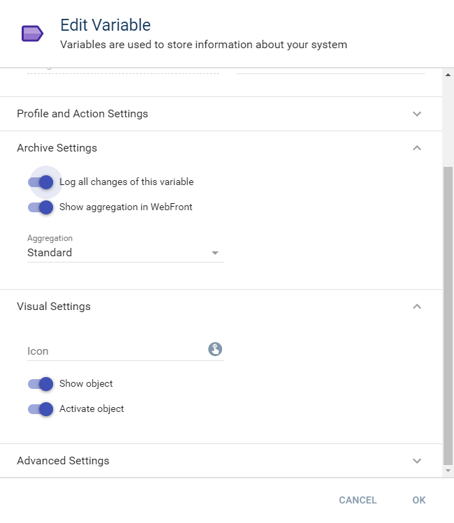

This function changes the property for logging the variable with the ID VariableID to Active.
The logging of the variables is activated immediately, but since the current value and changes to the variables are logged asynchronously, it is possible that these are not directly available when a script is executed. A possible workaround for this is to use the sleep command
// Sets the property of the "test variable" for logging to true
AC_SetLoggingStatus(39147 /*[Archive]*/, 53716 /*[TestVariable]*/, true);
