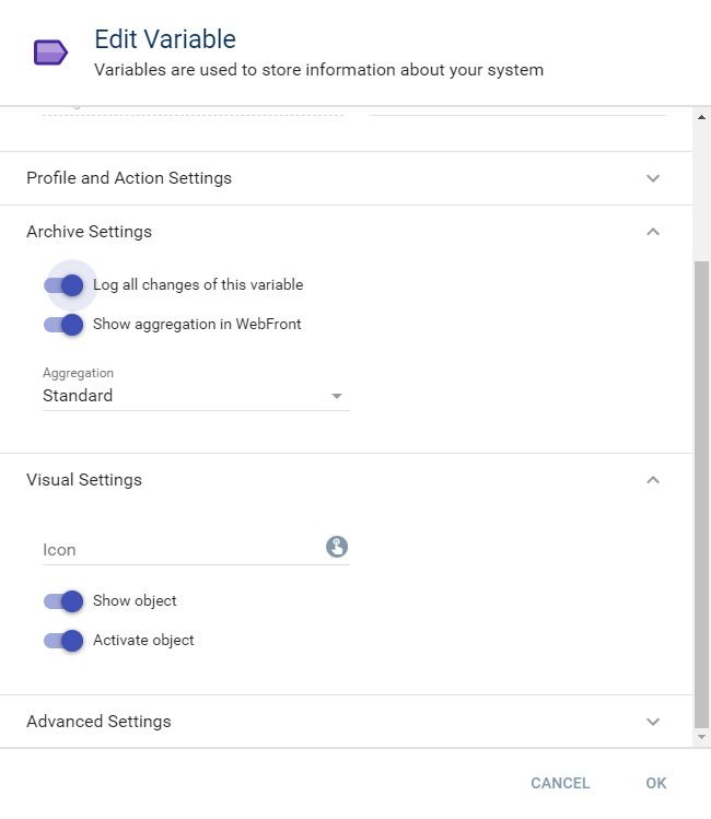

Activate logging
To log a variable in the database, it must be selected for it. You will need to edit the variable and select the checkbox "Log all changes of this variable". If no button for showing the graph is wanted, deactivate the option "Show aggregation in Visualization".
Variable loggen
Aggregation Type Description
Standard For all aggregationlevels (hour, day, week, month, year) will min / max / average calculated.
Counter For all aggregationlevels (hour, day, week, month, yea) will the delta (difference) of the values as min / max / sum calculated.
If the Counter aggregation is used, the first value logged in the archive is used as reference value and the sum of positive delta starts with the following value. That means a variable with the logged values 500, 505, 520, and 521 is displayed with the values 0, 5, 15, 1.
Archive settings Description
Log all changes of this varaible Activates the logging of the variable.
Show aggregation in Visualization Deactivate/Hide the button for showing the visualization of the logged variable. The logging ist still active for the varabelDas Aufzeichnen der Datenpunkte der Variable ist immernoch aktiv.

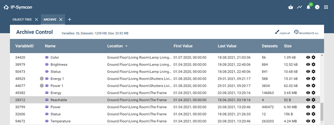

Archive Handler
The Archive Handler is a function to manage all logged variables. All values can be viewed and edited.
Archive Handler Kern Instance
Archive Handler
The header provide following functions:
Function Description
Clean up Removes all archivedata from nonexistent variables. Data of deactivated variables won't get deleted.
Reaggregate all Aggregates all logged variables again. Depending on the scope, this may take a very long time. Regular status and finishing messages are available in the tab "Message Log".
Clicking the eye icon opens the view with saved raw data of the selected variable and allows the deletion of individual datasets. After deletion, it is required to reaggregate the variable data. This function is not available for variables that do not exist any more. A click on the cog wheel opens a dialog with extended functions for the selected variable

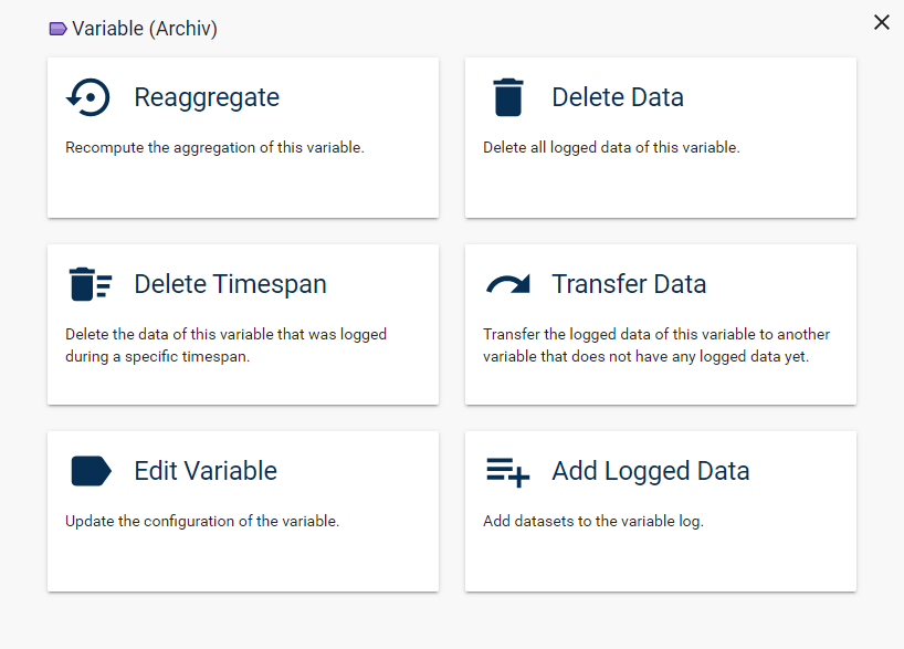

Variablenfunktionen
Reaggregate Aggregates the selected variable again. Depending on the scope, this could take very long. Regular status and finishing messages are available in the tab "Message Log".
Delete Deletes all the raw data from the archive.
Delete timespan A time interval can be selected here. All datasets within that interval are deleted.
Transfer data The raw data of a variable is transferred to another variable. This can be useful if a VariableID does not exist any more or a sensor is replaced. A variable must be selected which is not logged yet and whose variable type fits the data. The data of the old variable will be automatically deleted in this process.
Edit variable Opens the dialog to edit the Variable
Add logged data Additional datasets can be added here. Datasets can either be entered manually or from files. For manual adding, another dialog opens, in which a list of times and values can be entered, that are added to the variable with a click on "Add Values". If datasets from files should be added, accordingly prepared csv files are required. In an additional step the values can be checked manually and finally be added to the variable.

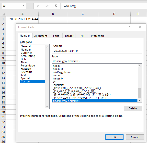

Add files from Excel file
It is possible to prepare the .csv files for adding with Microsoft Excel. Here, the points in time are entered into the first column and the values into the second. Verify that the point of time is formatted in one of the supported formats. For example, the German format can be used with the user defined number format DD.MM.YYYY hh:mm:ss.
Format Cells
Finally, the list can be saved as .csv file via "Save as" and the type "CSV (Seperator delimited)" and finally confirming with "Save". The generated .csv file kann be added in IP-Symcon via "Add Data" of a Variable.
