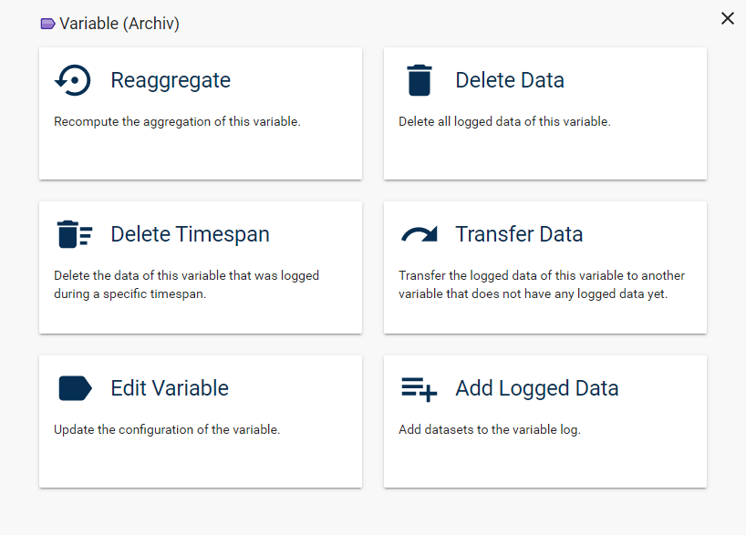

This function migrates the data of the variable with the ID OldVariableID into the variable with the ID NewVariableID.

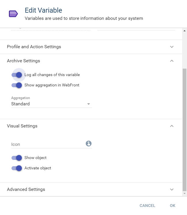

The variable with the ID NewVariableID must not be logged. This also means that no old data records may be available through logging.
