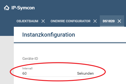

The building blocks that are connected to the 1-Wire bus do not send their values automatically - they must be requested. The Interval in the respective instance configuration defines how often the request is done.
Every request takes time and occupies the bus. For this reason, the "Interval" should be used sparingly. In practice, for example, a request cycle of 60 seconds to read a room temperature is more than sufficient. Smaller values under one second cannot be configured for that reason.
