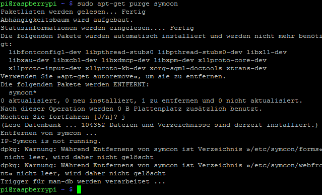

Uninstallation
The IP-Symcon service needs to be terminated before uninstalling.
Terminate Service/Server
The command to terminate IP-Symcon server needs to be entered via console. This is identical for Linux and Raspberry Pi.
sudo /etc/init.d/symcon stop
Uninstall Service/Server
The shown command needs to be entered via console. This is identical for Linux and Raspberry Pi.
sudo apt-get purge symcon
Delete IP-Symcon
Finalize the uninstallation by deleting the complete IP-Symcon-Data folder (/var/lib/symcon).
