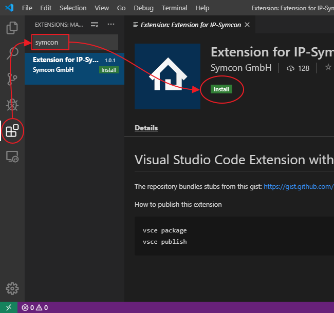

Extension browser in VSC
  • Call up "Extensions"
  • Search for "Symcon"
  • Select the "Extension for IP-Symcon" and click on "Install" to install it
  • In the Extensions area under "Installed" -> "Extension for IP-Symcon" should now appear
