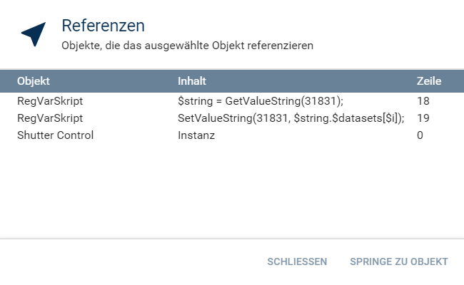

References indicate which objects require oneself to function properly. For example, during a reference search for a variable, a triggered event is listed which is triggered when the variable changes. Without the variable, the event cannot function properly.
The references are called up by default via the context menu in the object tree. One can then jump to the objects in the displayed list.
References in the object tree
