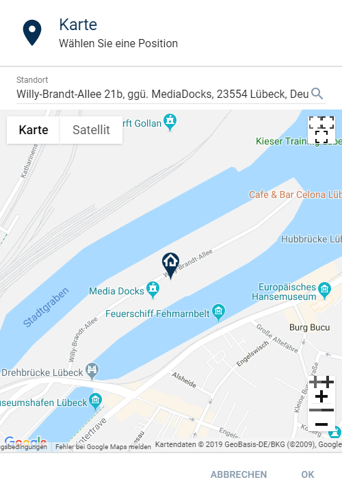

Creates an input for a position with the caption caption. Here, the position can be selected via map if internet access is available. Alternatively, the longitude and latitude can also be entered manually.
