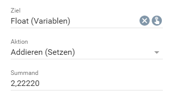

SelectAction
Require: IP-Symcon >= 6.0
Creates an input for an action .

Example 1: Target, Environment and InstanceID are constantly saved as part of the property
By default, all required parameters are saved as a return from SelectAction. This is the easiest way to perform the action.
{ "type": "SelectAction", "name": "PropertyAction", "targetID": 12345 } // PHP code in the module $action = json_decode($this->ReadPropertyString('PropertyAction'), true); IPS_RunAction($action['actionID'], $action['parameters']);
