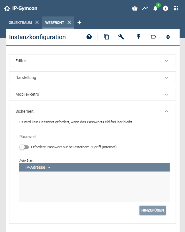

In this tab a password query for the WebFront and its editor can be set up.

Security tab in the WebFront configurator

Required password
For each configurator, a password can be assigned as access protection. This password is required before accessing the respective configurator, or during the configuration within the mobile apps. In addition, the special option can be activated, in which the password is not required within the local network. This password is only valid for accessing the system and its components. The query of the available configurators (Mobile) and the WebFront start page (overview) it is available at any time without a password.
Autostart for IP-address
A special function is the autostart, which opens a configurator directly without a password request if the IP address matches one of the entered IP addresses in this list. This function can be used for example to open a WebFront directly on a touch panel without having to display the normal selection dialog and without having to answer the password prompt. It is important to remember to use this feature only within a secure network.
Since IP-Symcon 5.5 the CIDR notation is also supported. For example, 192.168.1.0/24 includes all addresses from 192.168.1.1 to 192.168.1.255.
This function is not available if IP-Symcon is accessed via a Reverse Proxy or the Connect Service as the origin cannot be verified securely. An exception is the CIDR value Wert 0.0.0.0/0, which forwards all requests, independently of the origin.
