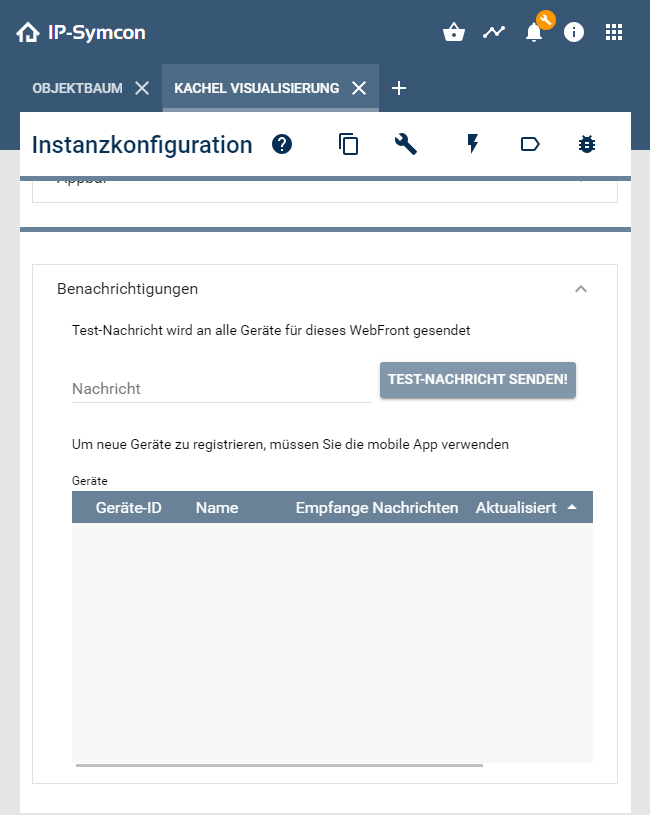

The tab provides an overview of the registered devices. It is possible to select whether the respective device receives messages.
A test message can also be sent.
registration to push messages service
Once a mobile device successfully logs into a visualization for the first time, that device is automatically added to the push message service for that instance. If no push messages are to be sent to this device, then this device must be explicitly deactivated for reception in the list. It should be noted that the registration to the push message service remains unaffected if the password for the visualization is changed. If a device is completely removed from the list, it will be treated as an unknown device the next time it logs in and will be added to the push message service again.
