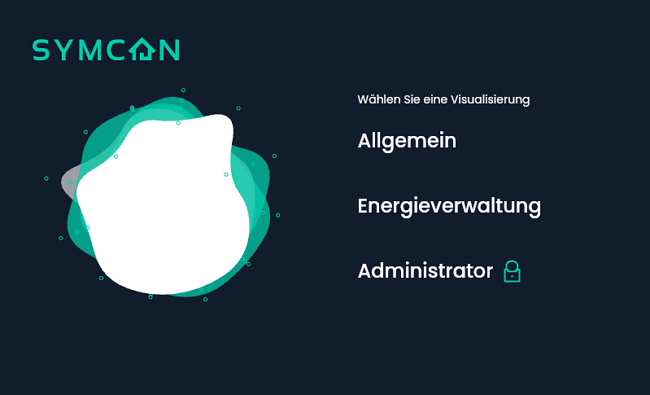

Select visualization
A list of the visualizations available on this server will then appear in the browser. If a visualization is password protected, this is symbolized by a lock icon. With one click the visualization to be opened can be selected. If the visualization is not password protected, it will be opened directly.

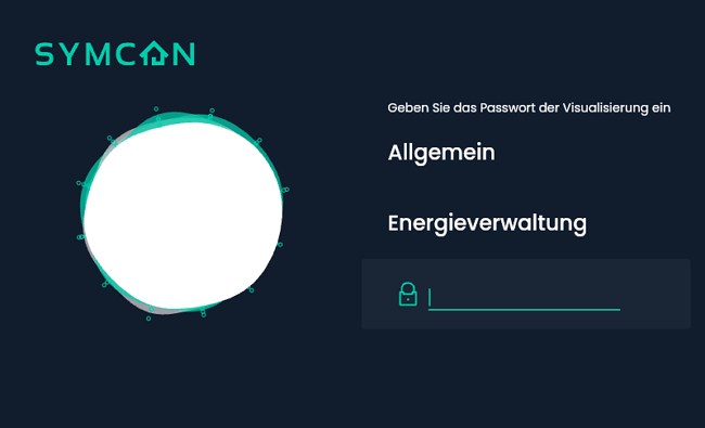

Otherwise a text field appears for entering the password. There the password must be entered and finally confirmed with Enter. If the password is correct, the visualization will be opened.
