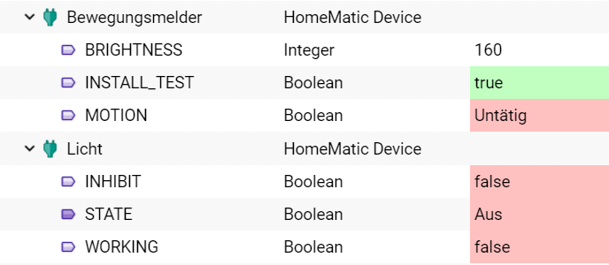

Given are 1 Homematic motion detector and 1 Homematic actuator for switching a light:

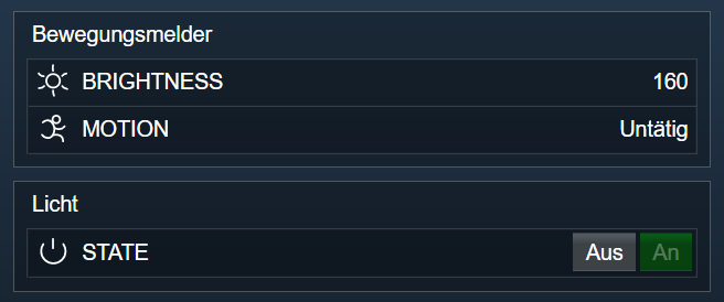

View of the two actuators in the WebFront

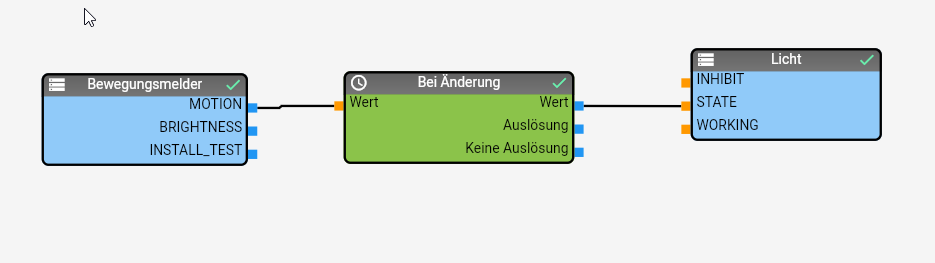

A logic script is now to be created in Logic Scripts that automatically switches a light on or off again when the motion detector is triggered.
You can implement this behavior by using a With change, predefined instance modules for setting the values can be found in the object tree of the logic script designer.
In this specific case, the logic script is called up each time the status variable of the motion detector is changed and applies its status to the light.
