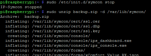

Raspberry Pi - Load Backup
Stop the IP-Symcon service:
sudo /etc/init.d/symcon stop
Extract the file backup.zip in the home folder into the folder "/var/lib/symcon/":
sudo unzip backup.zip -d /var/lib/symcon/
Restart the IP-Symcon service:
sudo /etc/init.d/symcon start
