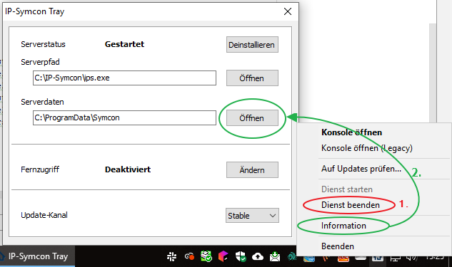

Windows - Create Backup
The whole content of the folder C:\ProgramData\Symcon needs to be compressed as backup.zip.
  1. Stop the Service via Tray Icon.
  2. Open the Data folder via "Tray Icon -> Information -> Server Data -> Open" and select all files and folders.
  3. Compress the files via "Right click -> Send to -> Compressed (zipped) folder" to create a .zip file. The file needs to be renamed to backup.zip.
  4. The backup should be copied or moved to an appropriate medium.
  5. Start the Service via Tray Icon.
If a message about empty folders appears while creating the Zip file, it can be ignored safely. Missing empty folders are created by IP-Symcon on demand.
ProgramData über Tray öffnen

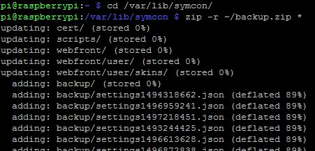

Raspberry Pi - Create Backup
The whole content of the folder "/var/lib/symcon" needs to be compressed as backup.zip.
zip may need to be installed.
sudo apt-get install zip
First, stop the IP-Symcon Service.
sudo /etc/init.d/symcon stop
Go to the Symcon folder and compress the folder.
cd /var/lib/symcon/ //Go to IP-Symcon folder
zip -r ~/backup.zip * //Compress the whole folder into backup.zip
RPi Zip Datei
The backup.zip is stored in the home folder. It can be copied or moved anywhere.

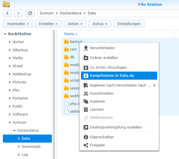

Docker/Synology/QNAP - Create Backup
As an example we use a Synology system.
First, stop the IP-Symcon container.
The container needs to be stopped via the container management of the used system.
Afterwards, the mounted Symcon folder needs to be opened to pack the folder.
The volume on which the folder was "mounted" can be seen in the settings of the image. According to the installation tutorial, the default is in the format "/Symcon/[MeinIPSymcon]/Data".
Finally, select all content and select "Compress" via right click.
Docker Zip Datei
The backup.zip is stored on the file system and can be downloaded.
Start the IP-Symcon container.
