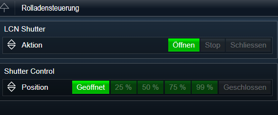

Rollladensteuerung
With the "Shutter Control", shutters that usually only support "Up" and "Down" can drive to percentual positions like 25% or 50%.

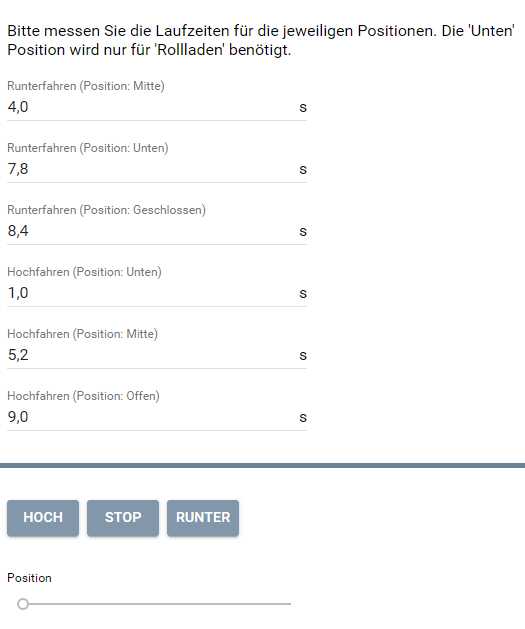

Konfiguration der Rollladensteuerung
This is realized by measuring the duration of rising or lowering. IP-Symcon automatically computes how long it takes to move the shutter to the desired position and stops the shutter once it is reached.
